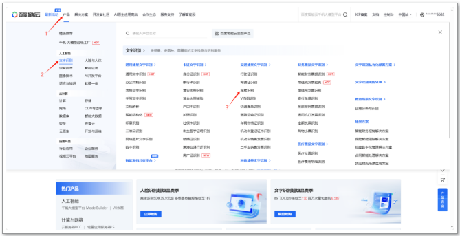

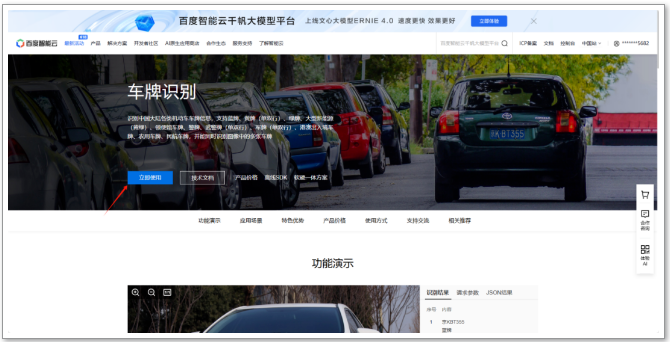

编译车牌识别的应用需要依赖Curl库、OpenSSL库、OpenCv库、JsonCPP库。详细的依赖库安装步骤请参考以下链接:
bbs.elfboard.com/forum.php?mod=viewthread&tid=496&extra=page%3D1
bbs.elfboard.com/forum.php?mod=viewthread&tid=495&extra=page%3D1
bbs.elfboard.com/forum.php?mod=viewthread&tid=497&extra=page%3D1
bbs.elfboard.com/forum.php?mod=viewthread&tid=498&extra=page%3D1
应用编译
elf@ubuntu:~/work$ . /opt/fsl-imx-x11/4.1.15-2.0.0/environment-setup-cortexa7hf-neon-poky-linux-gnueabi
elf@ubuntu:~/work$ $CXX demoCar.cpp -o demoCar -I /home/elf/work/curl-7.71.1/install/include/ -I /home/elf/work/jsoncpp-1.9.5/install/include/ -I /home/elf/work/opencv-3.4.1/install/include/ -std=c++11 -L /home/elf/work/curl-7.71.1/install/lib/ -L /home/elf/work/jsoncpp-1.9.5/install/lib/ -L /home/elf/work/opencv-3.4.1/install/lib/ -lopencv_core -lopencv_highgui -lopencv_imgproc -lopencv_videoio -lopencv_imgcodecs -lcurl
编译完成将文件通过scp拷贝到ELF 1开发板运行即可,这样就可以将本地的车牌图片通过HTTPS发送到百度智能云进行识别,并将识别结果返回。

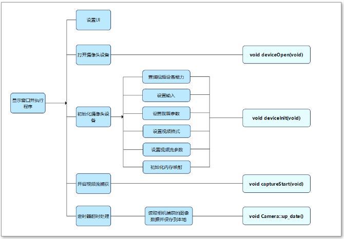

int main(int argc, char *argv[])
QApplication a(argc, argv);
Camera w;
w.setWindowFlags(w.windowFlags() & ~Qt::WindowMaximizeButtonHint & ~Qt::WindowMinimizeButtonHint);
w.showMaximized();
w.show();
return a.exec();
设置UI
ui->setupUi(this);
timer = new QTimer;
QDesktopWidget* desktopWidget = QApplication::desktop();
QRect screenRect = desktopWidget->screenGeometry();
qDebug("screen.width = %d , screen.height = %d", screenRect.width(), screenRect.height());
this->imageWidget = new ImageWidget(this);
this->imageWidget->setBackgroundRole(QPalette::Dark);
this->imageWidget->setSizePolicy(QSizePolicy::Ignored, QSizePolicy::Ignored);
this->imageWidget->setObjectName(QString::fromUtf8("imageWidget"));
if (screenRect.width() == 800)
ui->pbt_start->setGeometry(60, 300, 70, 50);
ui->pbt_stop->setGeometry(190, 300, 70, 50);
this->imageWidget->setGeometry(QRect(5, 30, 350, 250));
else if (screenRect.width() > 800)
ui->pbt_start->setGeometry(80, 400, 70, 70);
ui->pbt_stop->setGeometry(260, 400, 70, 70);
this->imageWidget->setGeometry(QRect(6, 37, 500, 330));
打开摄像头设备
void deviceOpen(void)
fd = open(deviceName, O_RDWR | O_NONBLOCK, 0);
if (-1 == fd)
QMessageBox::about(NULL, "About", "camera open error");
exit(EXIT_FAILURE);
初始化摄像头设备
void deviceInit(void)
struct v4l2_capability cap;
struct v4l2_cropcap cropcap;
struct v4l2_crop crop;
struct v4l2_format fmt;
struct v4l2_streamparm sparm;
unsigned int min;
if (-1 == xioctl(fd, VIDIOC_QUERYCAP, &cap))
if (EINVAL == errno)
QMessageBox::about(NULL, "Information", "no V4L2 device");
exit(EXIT_FAILURE);
else
errno_exit("VIDIOC_QUERYCAP");
if (!(cap.capabilities & V4L2_CAP_VIDEO_CAPTURE))
QMessageBox::about(NULL, "Information", "no video capture device");
exit(EXIT_FAILURE);
struct v4l2_input input;
input.index = 0;
if (ioctl(fd, VIDIOC_ENUMINPUT, &input) != 0)
QMessageBox::about(NULL, "Information", "set input error");
exit(0);
if ((ioctl(fd, VIDIOC_S_INPUT, &input)) < 0)
QMessageBox::about(NULL, "Information", "set s_input error");
exit(0);
CLEAR(cropcap);
cropcap.type = V4L2_BUF_TYPE_VIDEO_CAPTURE;
if (0 == xioctl(fd, VIDIOC_CROPCAP, &cropcap))
crop.type = V4L2_BUF_TYPE_VIDEO_CAPTURE;
crop.c.top = 0;
crop.c.left = 0;
crop.c.height = 720;
crop.c.width = 1280;
if (-1 == xioctl(fd, VIDIOC_S_CROP, &crop))
switch (errno)
case EINVAL:
break;
default:
break;
CLEAR(fmt);
fmt.type = V4L2_BUF_TYPE_VIDEO_CAPTURE;
fmt.fmt.pix.width = width;
fmt.fmt.pix.height = height;
fmt.fmt.pix.pixelformat = V4L2_PIX_FMT_YUYV;
fmt.fmt.pix.field = V4L2_FIELD_ANY;
if (-1 == xioctl(fd, VIDIOC_S_FMT, &fmt))
errno_exit("VIDIOC_S_FMT");
if (width != fmt.fmt.pix.width)
width = fmt.fmt.pix.width;
// fprintf(stderr,"Image width set to %i by device %s.\n", width, deviceName);
if (height != fmt.fmt.pix.height)
height = fmt.fmt.pix.height;
// fprintf(stderr,"Image height set to %i by device %s.\n", height, deviceName);
min = fmt.fmt.pix.width * 2;
if (fmt.fmt.pix.bytesperline < min)
fmt.fmt.pix.bytesperline = min;
min = fmt.fmt.pix.bytesperline * fmt.fmt.pix.height;
if (fmt.fmt.pix.sizeimage < min)
fmt.fmt.pix.sizeimage = min;
CLEAR(sparm);
sparm.type = V4L2_BUF_TYPE_VIDEO_CAPTURE;
sparm.parm.capture.capturemode = 0;
sparm.parm.capture.timeperframe.numerator = 1;
sparm.parm.capture.timeperframe.denominator = 30;
if (xioctl(fd, VIDIOC_S_PARM, &sparm) < 0)
errno_exit("cam s parm");
// exit(1);
mmapInit();
开启视频流捕获
void captureStart(void)
unsigned int i;
enum v4l2_buf_type type;
for (i = 0; i < n_buffers; ++i)
struct v4l2_buffer buf;
CLEAR(buf);
buf.type = V4L2_BUF_TYPE_VIDEO_CAPTURE;
buf.memory = V4L2_MEMORY_MMAP;
buf.index = i;
if (-1 == xioctl(fd, VIDIOC_QBUF, &buf))
errno_exit("VIDIOC_QBUF");
if (-1 == xioctl(fd, VIDIOC_STREAMON, &type))
errno_exit("VIDIOC_STREAMON");
超时处理
void Camera::up_date()
unsigned char image_buf[921600 + 54];
frameRead(image_buf);
this->imageWidget->setPixmap(image_buf);
编译
elf@ubuntu:~/work/camera-demo$ . /opt/fsl-imx-x11/4.1.15-2.0.0/environment-setup-cortexa7hf-neon-poky-linux-gnueabi
elf@ubuntu:~/work/camera-demo$ qmake
elf@ubuntu:~/work/camera-demo$ make

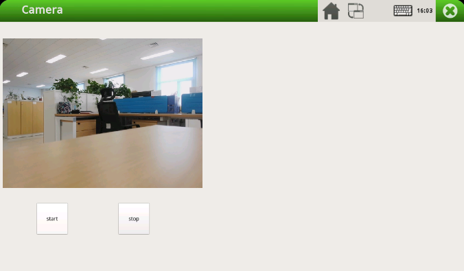

拷贝camera-demo到ELF 1开发板的/home/root路径下,运行测试
root@ELF1:~# cp /run/media/sda1/camera-demo ./
root@ELF1:~# chmod 777 camera-demo
root@ELF1:~# export DISPLAY=:0.0
root@ELF1:~# ./camera-demo
点击start按钮之后,使用ls num路径下查看会有摄像头拍摄的图片。液晶屏上会实时预览摄像头拍到的图像,如下图所示:
在这里就可以和前面车牌识别结合起来了,比如摄像头里面的画面是一张车牌信息,通过截取摄像头中的实时画面到本地,然后上传到百度智能云的后台进行识别,至此就完成了通过摄像头进行车牌识别的过程。

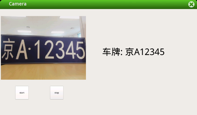

1、确保开发板已连接USB摄像头和屏幕
2、设置Wi-Fi连接
root@ELF1:~# elf1_cmd_wifi.sh -i 8723 -s 账号 -p 密码
执行应用
root@ELF1:~# ./camera-demo &
root@ELF1:~# ./demoCar
单击“start”按钮,识别结果如下图所示
